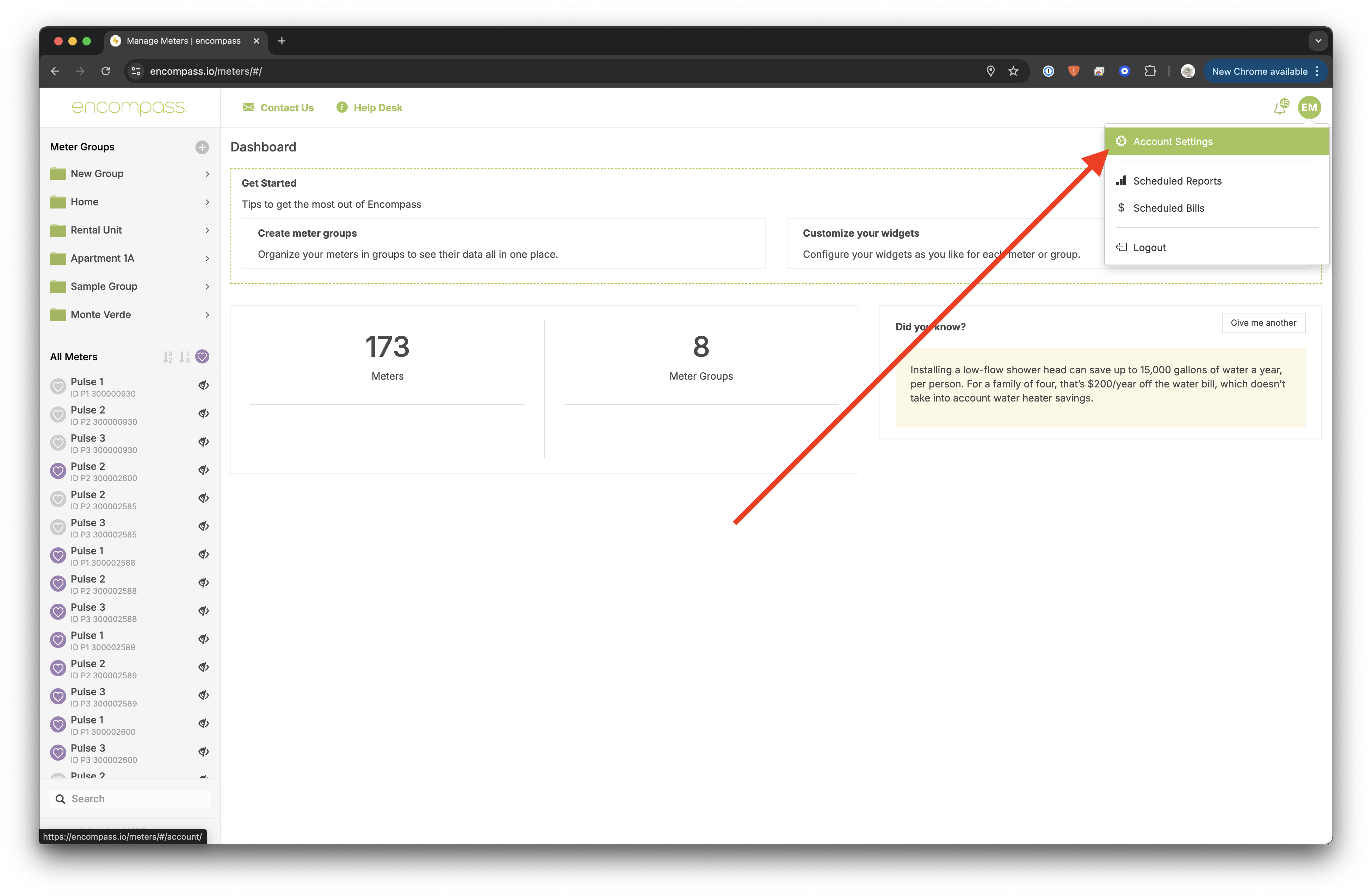

  2. Click the green circle with your initials in it, in the top right of the Encompass header.
  3. Click "Account Settings" from the options in the dropdown list.

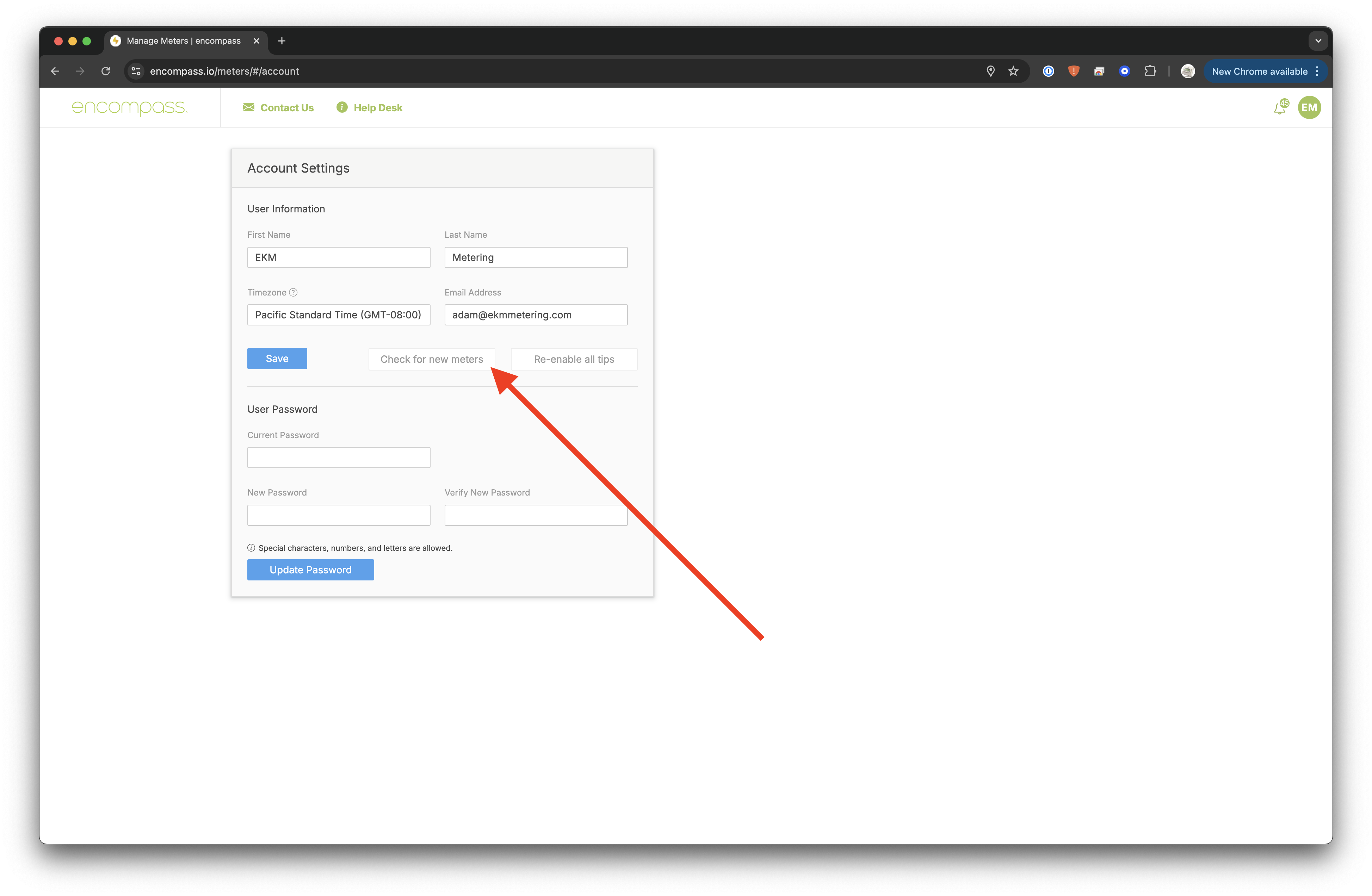

  4. Click the "Check for new meters" button.
  5. Click "Save" when you are ready.
