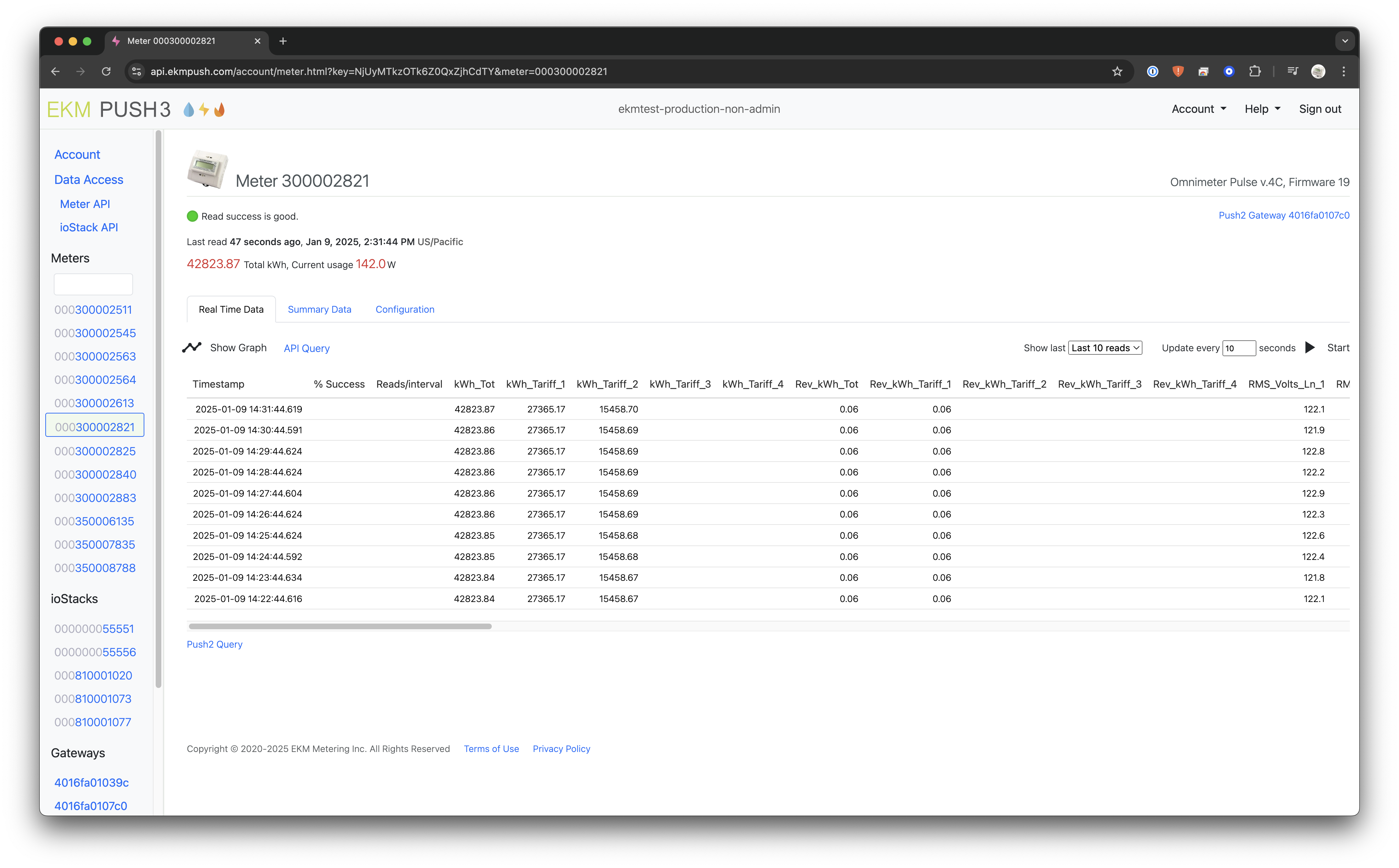

If you click on a meter in the left column you will be able to see a bit more information about that specific meter:

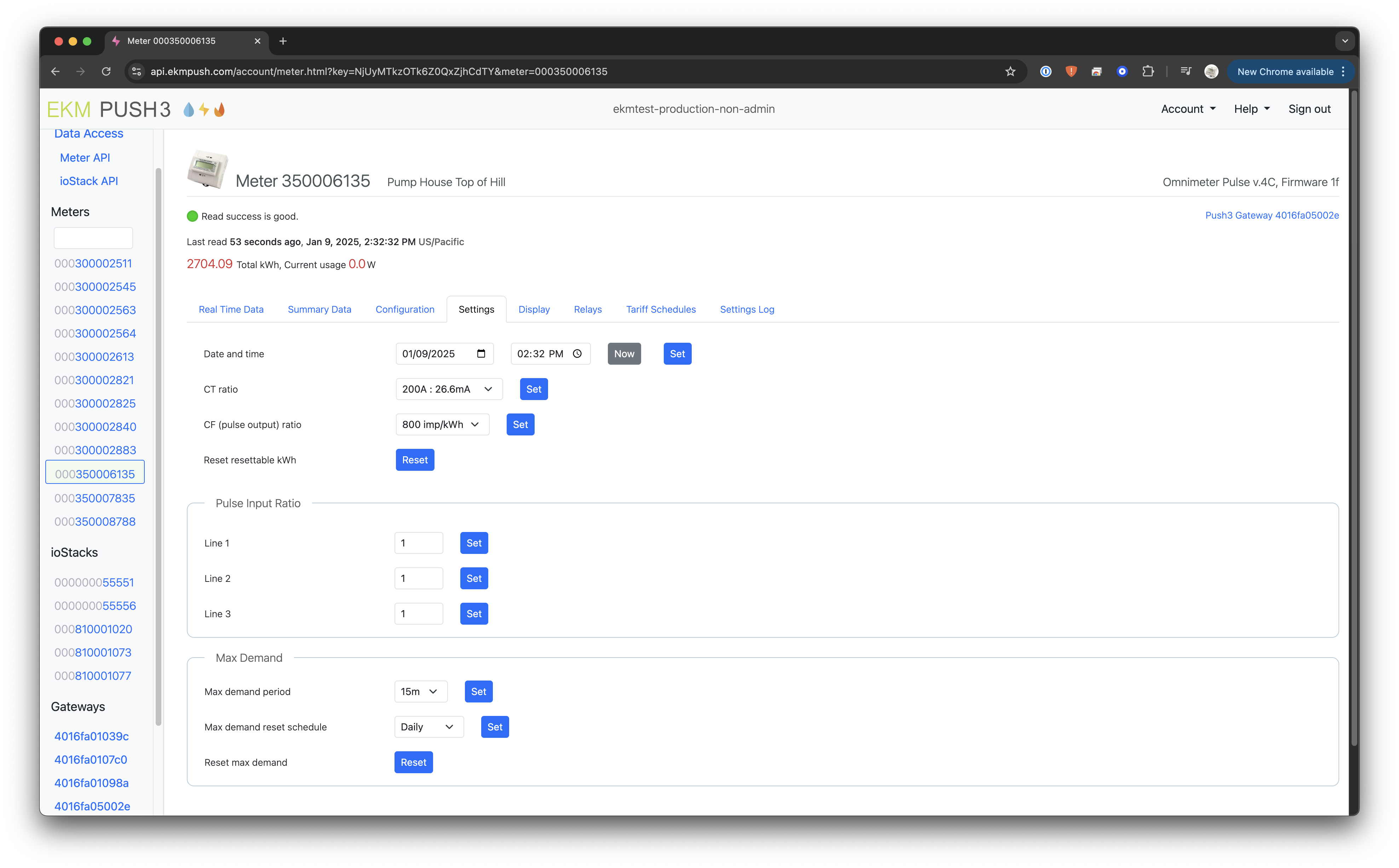

You can see the last 10 real time reads and their data (scroll right to see more data). If the meter is being read by a Push2 gateway you will only have viewable data. If the meter is being read by a Push3 gateway there will be additional tab for meter Settings and Settings Log. In the case of v.4 and v.5 Omnimeters, there will also be tabs for Relays (each v.4/5 Omnimeter has two controllable relays) and Display (the meter's settable LCD screen data registers).
Please note that settings and control capability is only available after you have registered your Push Account Portal.

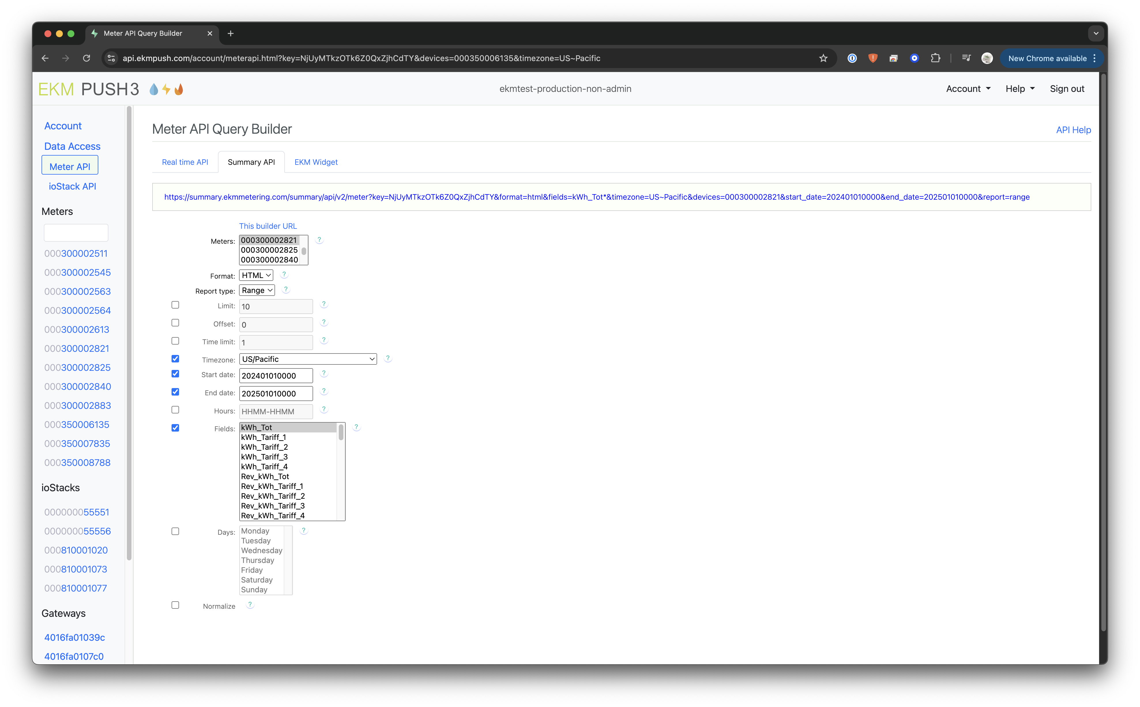

Towards the top of the left column you will find the option for API Query, which will allow you to specify the data that you want to view for each meter. Our software does this for you so you can try our software options first but our API allow you to be very specific with the data queries.
There are tabs for both the Real-Time API and our Summary API. We've documented both APIs here: https://documents.ekmmetering.com/api-docs/#introduction

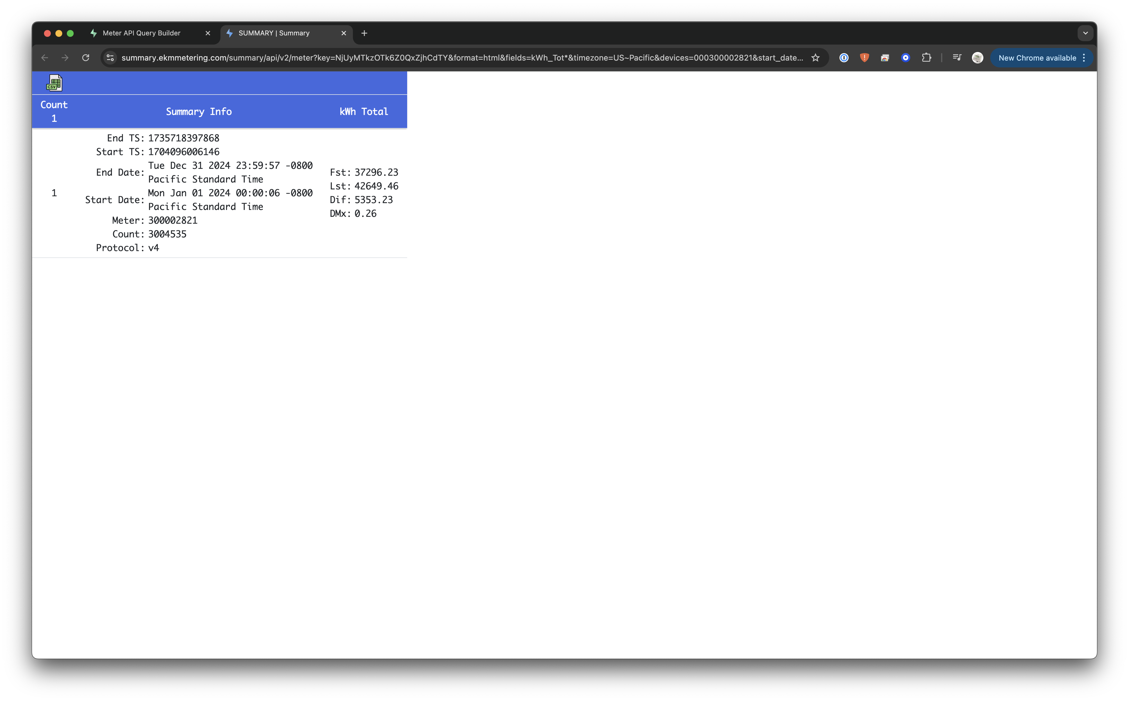

The API Builder crafts a URL for you that you can then click to execute the API call. The screenshot below shows the data that was retuned by entering the settings in the screenshot above.
Here is that API call: https://summary.ekmmetering.com/summary/api/v2/meter?key=NjUyMTkzOTk6Z0QxZjhCdTY&format=html&fields=kWh_Tot*&timezone=US~Pacific&devices=000300002821&start_date=202401010000&end_date=202501010000&report=range
There is also a "This builder URL" link at the top of the API Builder settings. When clicked this link will adjust the URL of the API Builder page you're on. This allows you to bookmark the page, or save the URL, so that you can return to the API Builder later and have the setting be the same as you set them before. This is helpful if you just want to make a couple changes to the date range, for example.
