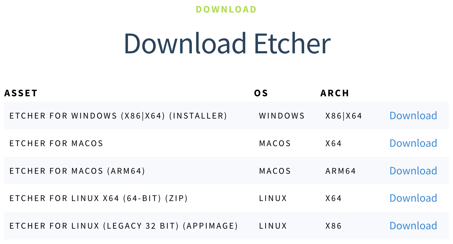

  1. Download balenaEtcher: https://etcher.balena.io/#download-etcher
    ⚠️ Important: Only use the official link above. Do not trust third-party websites like etcher.net or balenaetcher.eu.

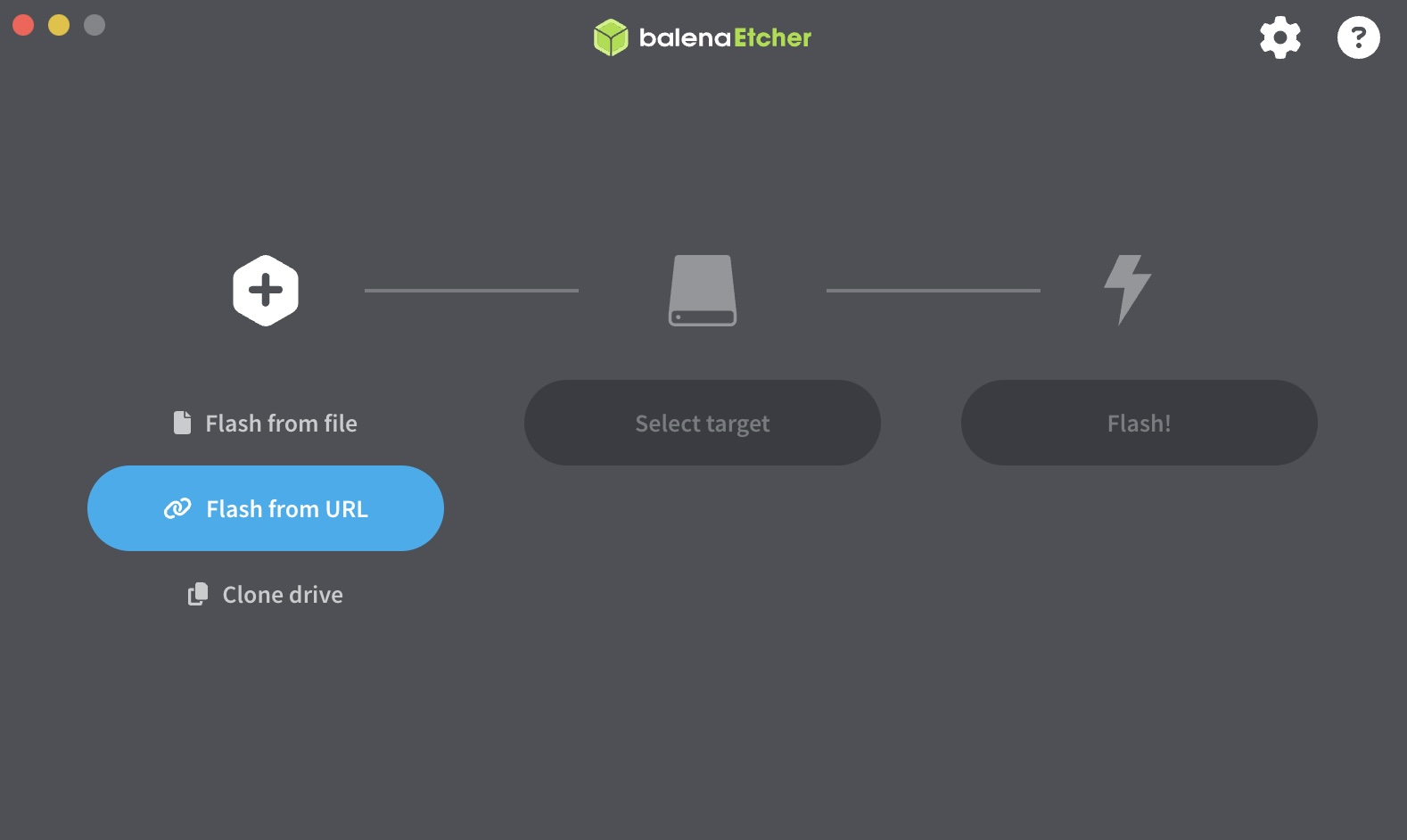

  2. Flash from URL
    1. Open belenaEtcher
    2. Click "Flash from URL"
    3. Copy/paste the following into the provided text box:
      https://images.ekmmetering.com/latest.img
    4. Click OK to confirm

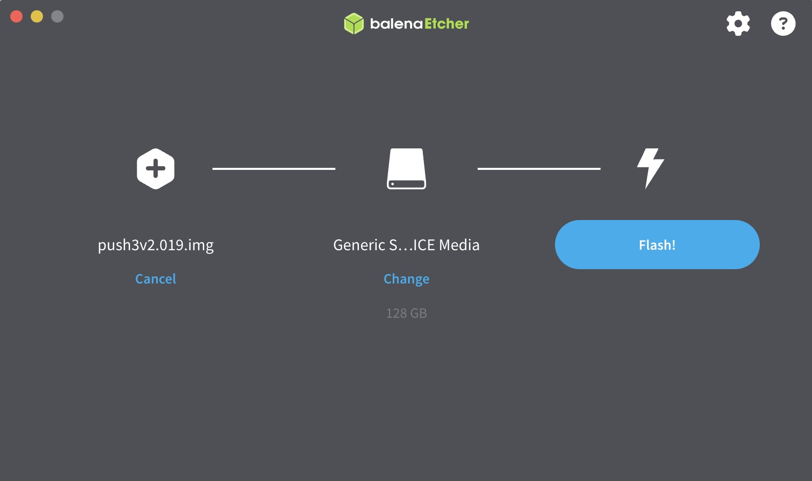

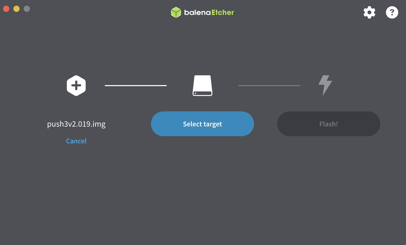

  3. Select the correct SD card
    1. Etcher will list all available storage devices, including hard drives and SD cards.
    2. Select the SD card you want to write the image to (not your internal hard drive).
    3. Check the size and label to be sure. For example:
      16GB Generic Storage Device Media
      500GB Samsung SSD (do not flash to this!)
  4. Flash the image
    1. Click the "Flash!" button
    2. Wait for the flashing to complete
    3. Once done, safely eject your SD card

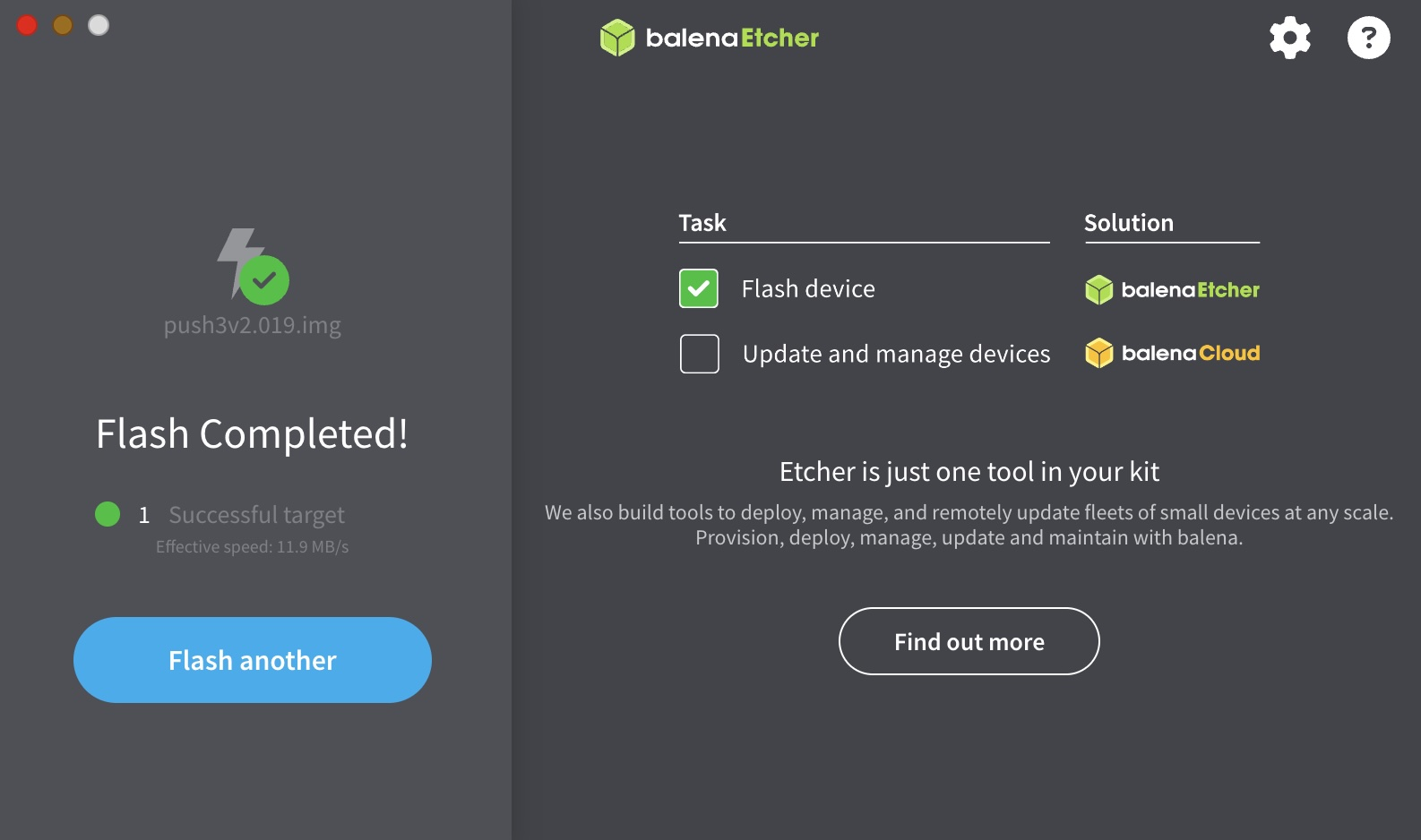

  5. Confirm Flash Completed
    You're ready to go! You should see Etcher showing it completed.

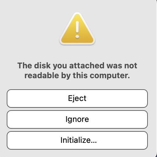

    If you also see a message like the one below, it's OK. Your computer just can't directly read the completed image because it's not compatible with it, but the gateway will read it fine if Etcher shows that the process completed. You can safely eject the prepared SD card.
