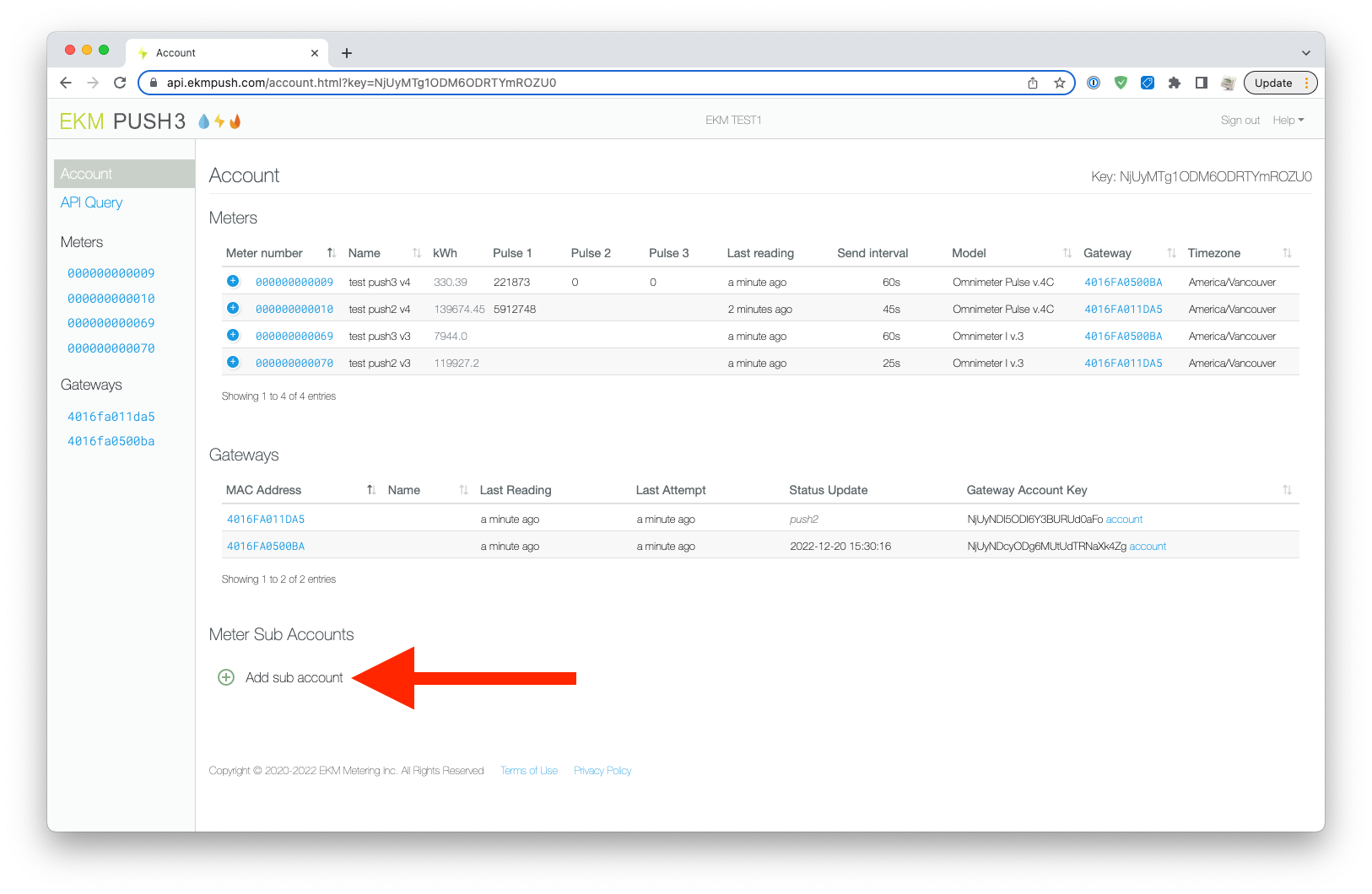

  2. At the bottom of your the main page of your Account Portal you will see a + icon and "Add sub account." Click on it.

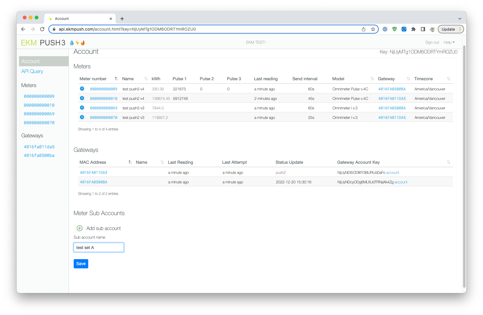

  3. Name the sub-account and click the 'Save' button.

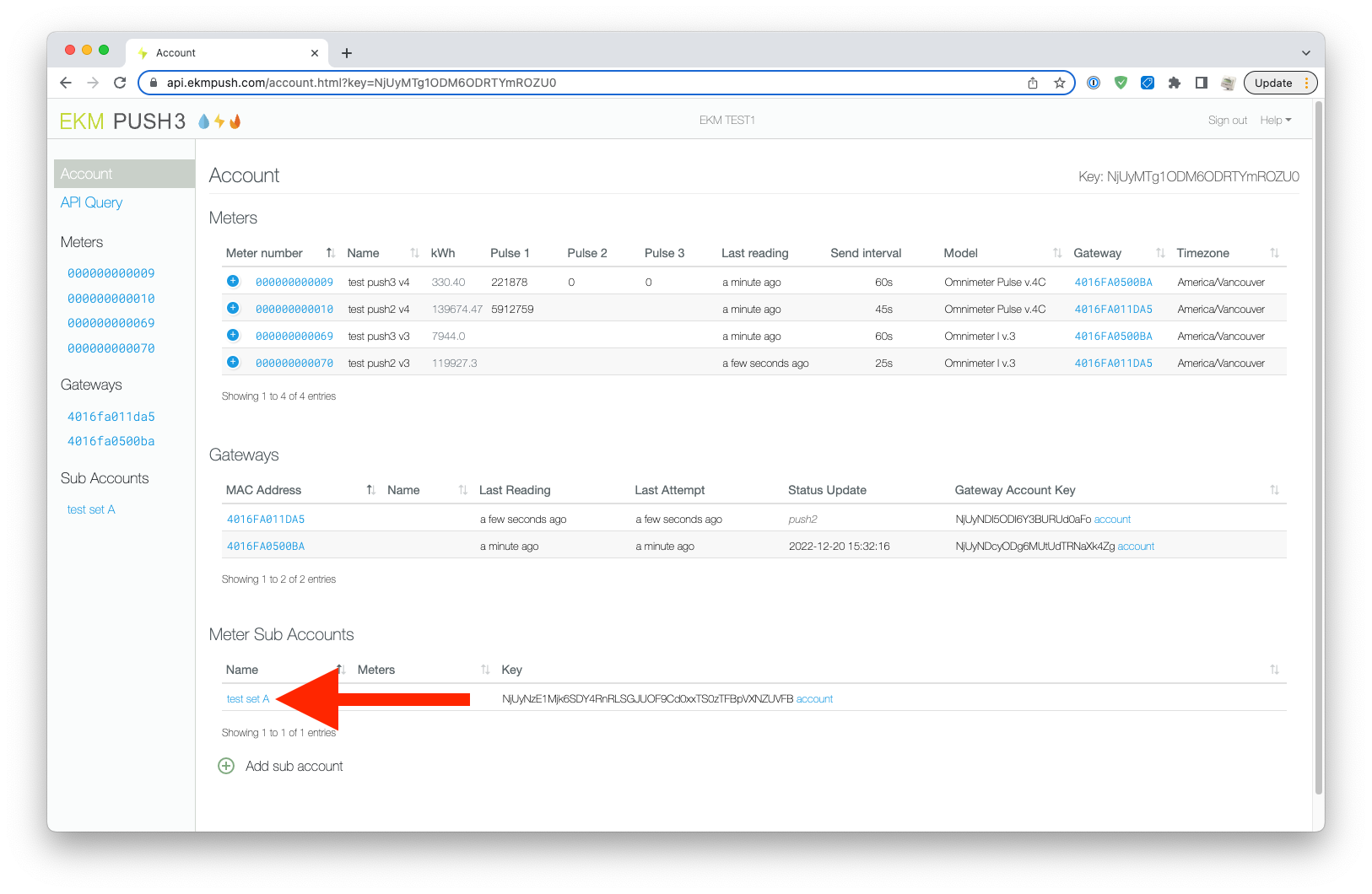

  4. Then click on the sub-account name that you just created.

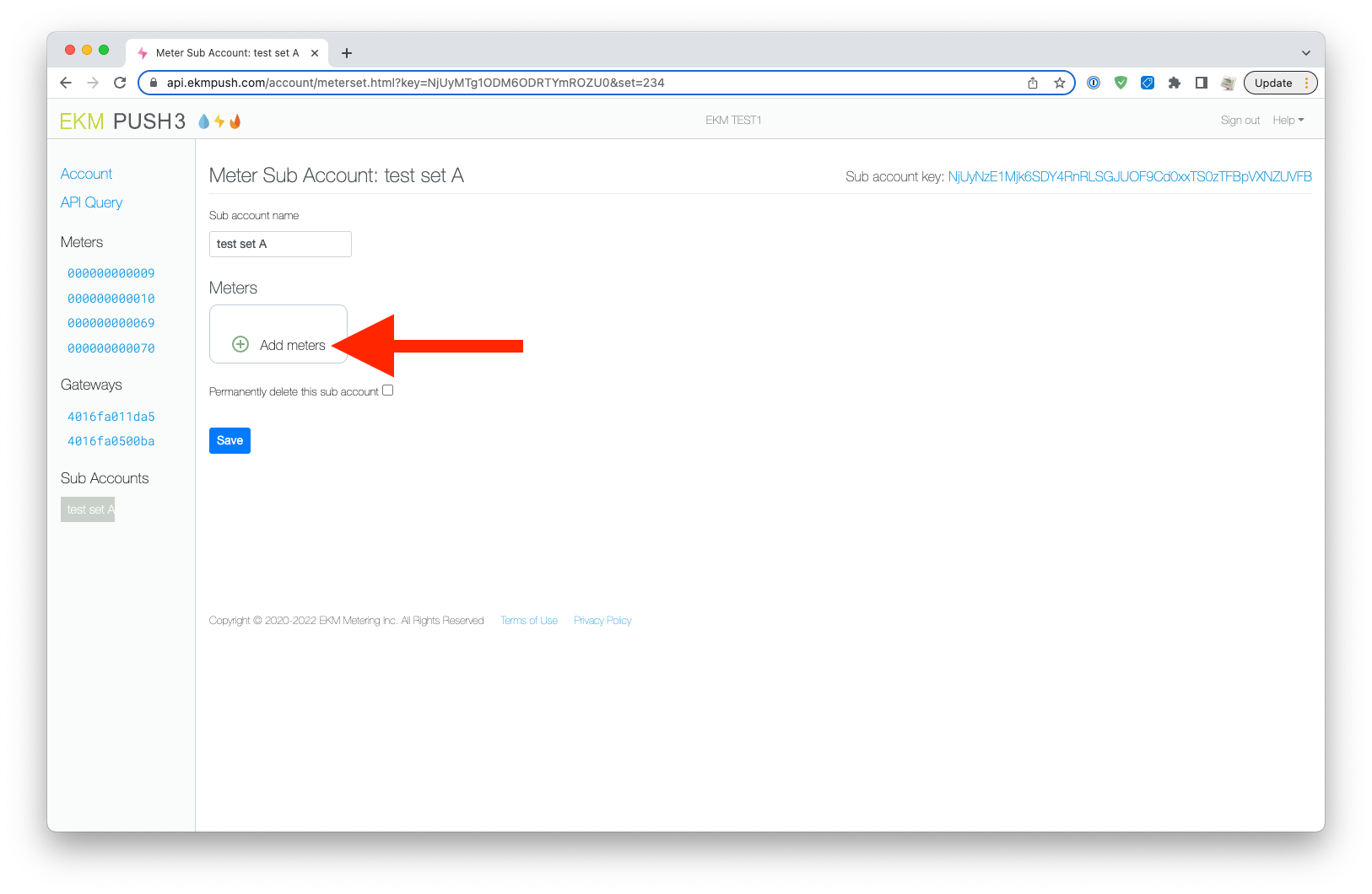

  5. Click on the 'Add meters' button.

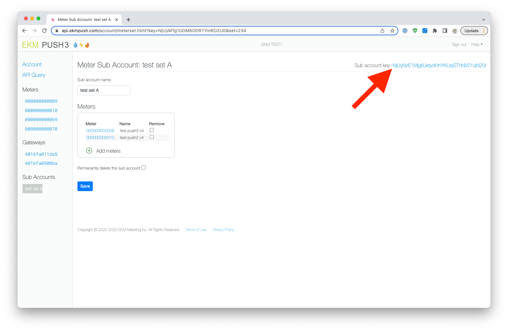

  8. You will see the sub-account key in the upper right of the window.
    It can also be found at the bottom of the main account page.
