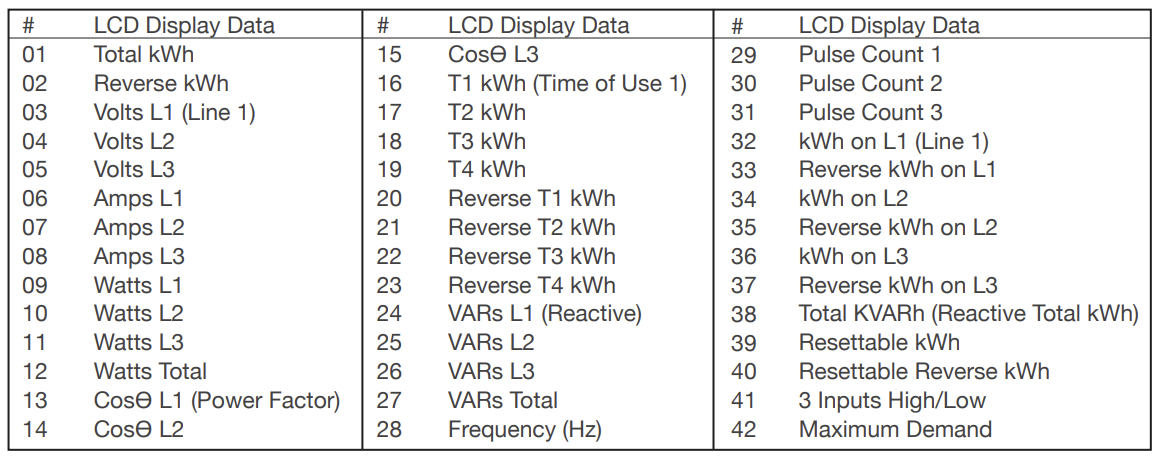

Each v.3 Omnimeter cycles through 15 different values on its LCD display. Each value is indicated by a number on the left of the meter's screen. This is what each number equates to:
* Added to Omnimeter I v.3 with serial number 34406 and above. And Omnimeter II UL v.3 with serial number and above 10028541.
v.4 Omnimeter models cycle through 40 different values on its LCD display by default. Each value is indicated by a number on the left of the screen. This is what each number equates to:
For Omnimeter Pulse v.4 with serial number above 350007780, and Omnimeter Pulse UL v.4 with serial number 300005860 and above, these additional LCD screen register options are available:

Below is an Omnimeter LCD screen that is displaying 01 at the small digits on the left, indicating the current LCD screen is showing Total kWh. It is currently reading 94712.29 Total kWh as an example. The black dot at the bottom reads T1, this indicates that the meter is currently adding kWh to the Time-of-Use bucket 1
