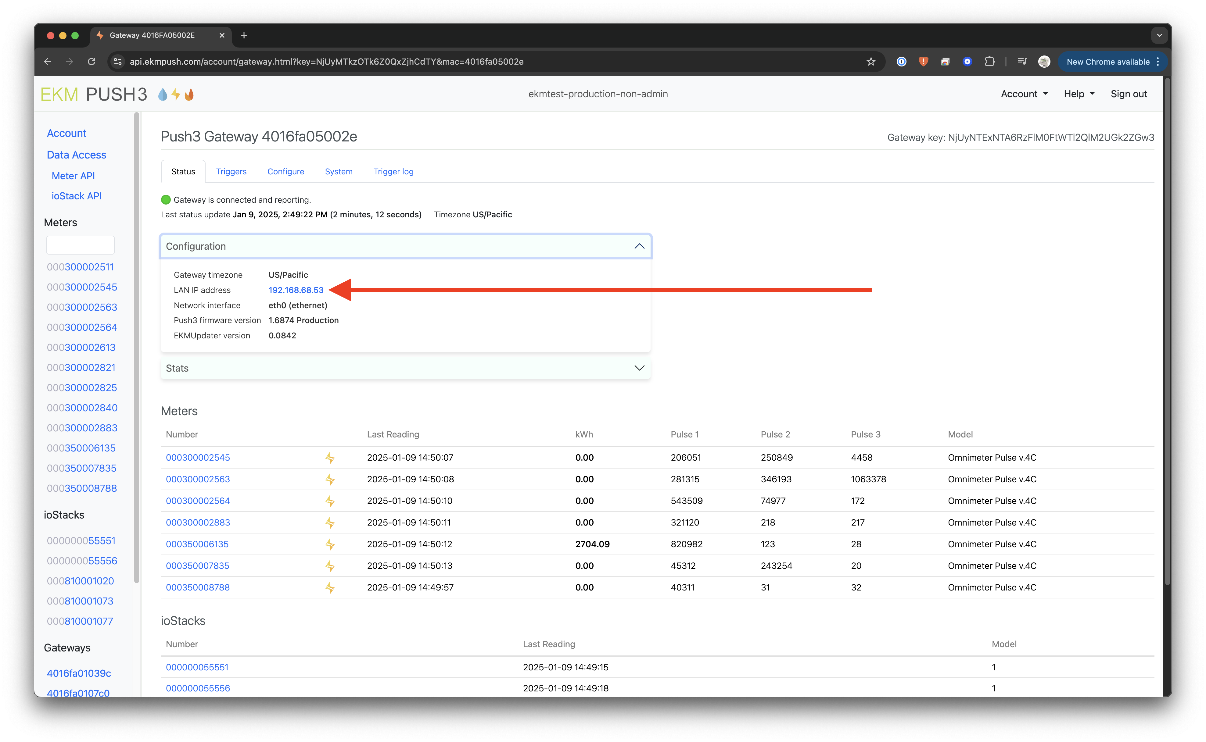

To access your Push3 gateway on you LAN:
- Find your Push gateway's IP address in your Account Portal by selecting the Push gateway in the left column.
- The default User is admin and the default password is the Gateway Key, which can be found in your online EKM Push Account Portal. More on where to find the Gateway Key can be found here. Before Push3 firmware v1.684 there was no password required.
