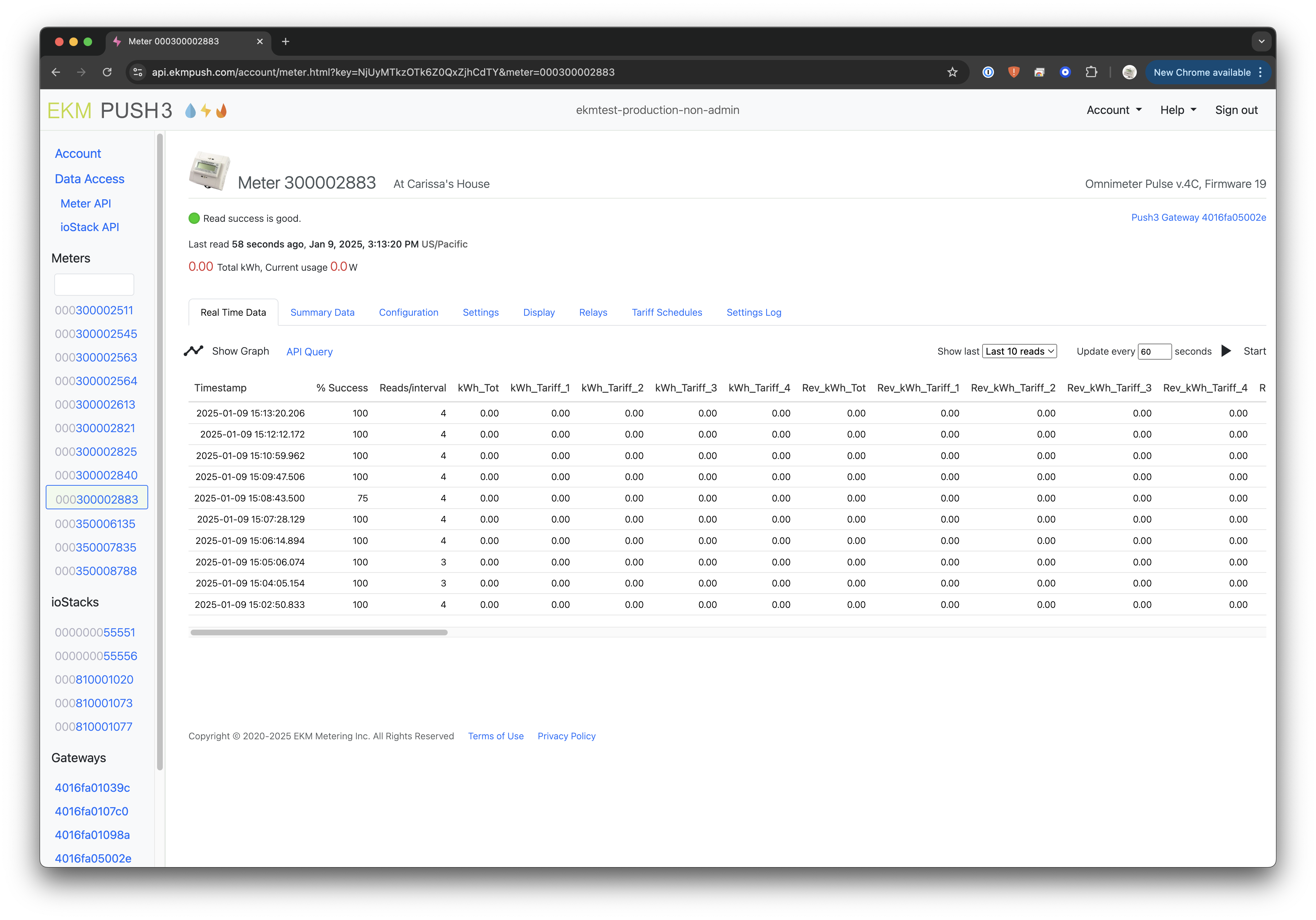

- Log in to you online Account Portal or register your account portal if you haven't already
- Select the meter, from the left column, that you would like to assign to a Push3

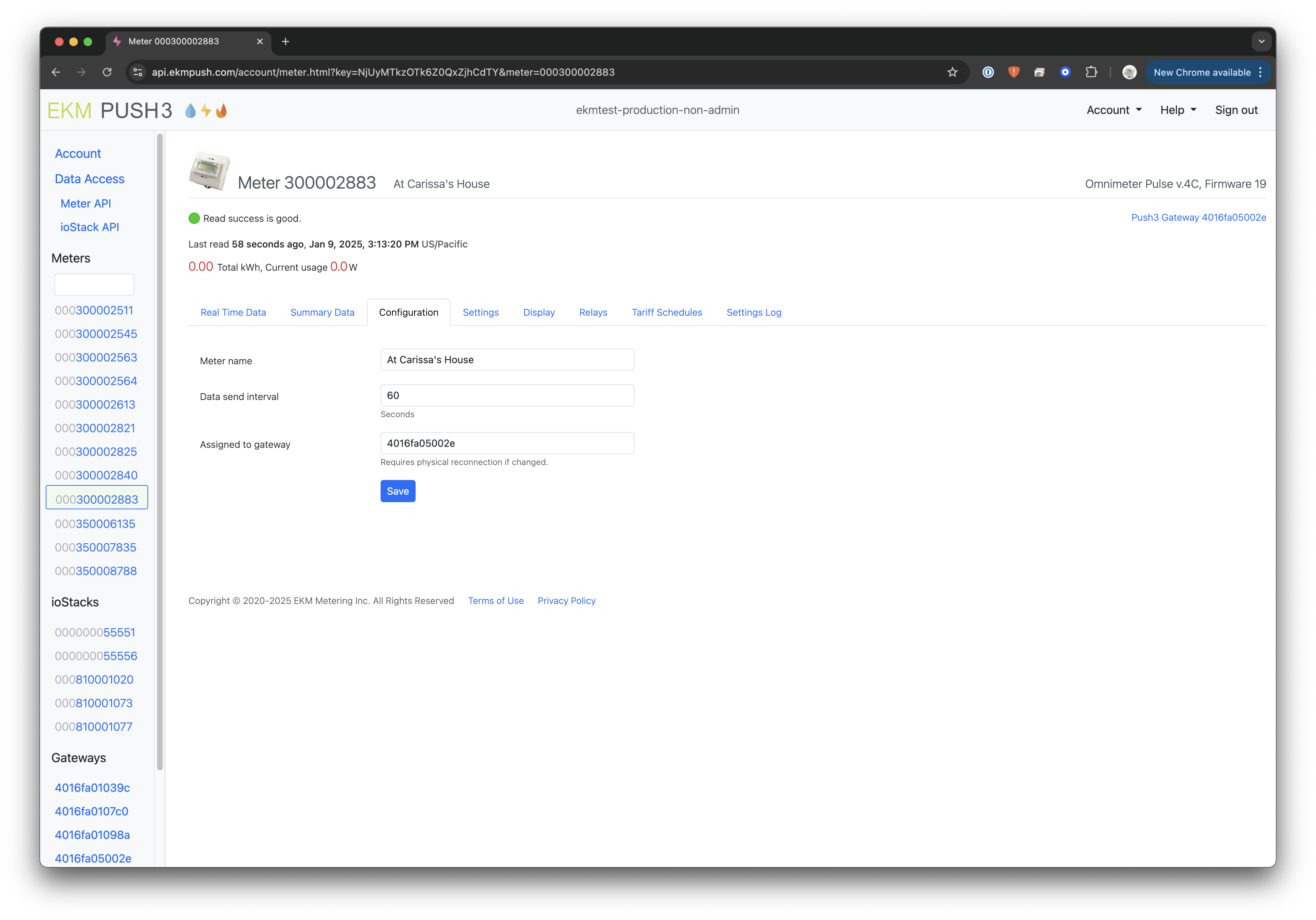

- Click on the Configuration tab

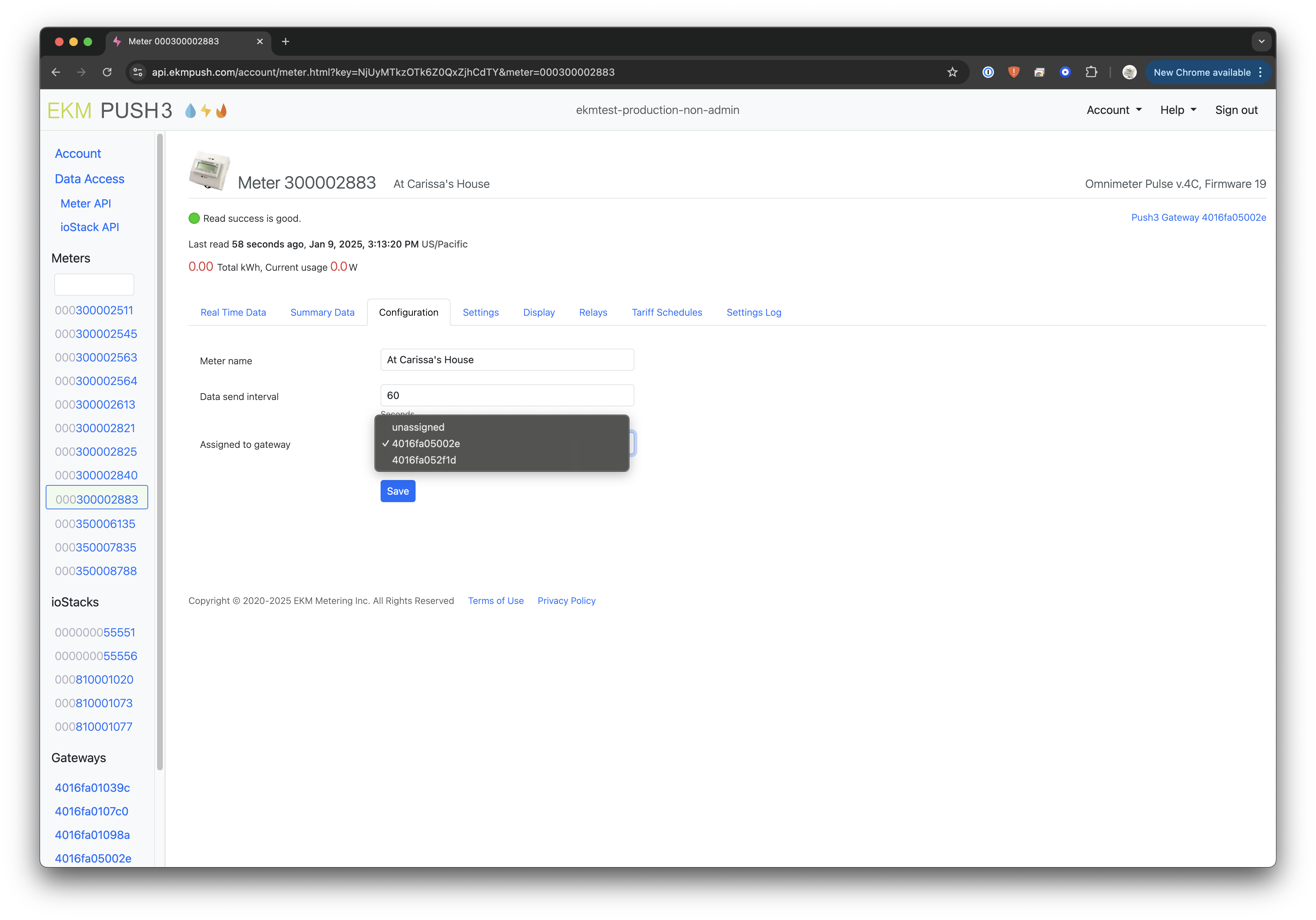

- Select the Push3 MAC address from the available option in the dropdown list. On your Push3 gateway the MAC address is on a sticker near the ethernet port.
- You can also name your meter at the same time, using the available text box
- Click the save button when you are ready. The new meter assignment can take up to an hour to take affect. Power cycling the Push3 gateway will often speed up the process.
