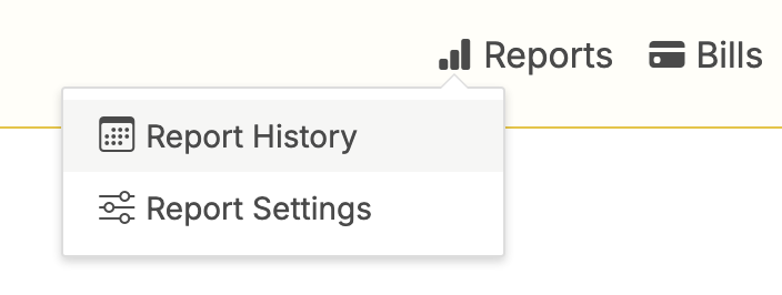

  2. Click the Reports button on the right side of the dashboard header (the yellow header in the example below).

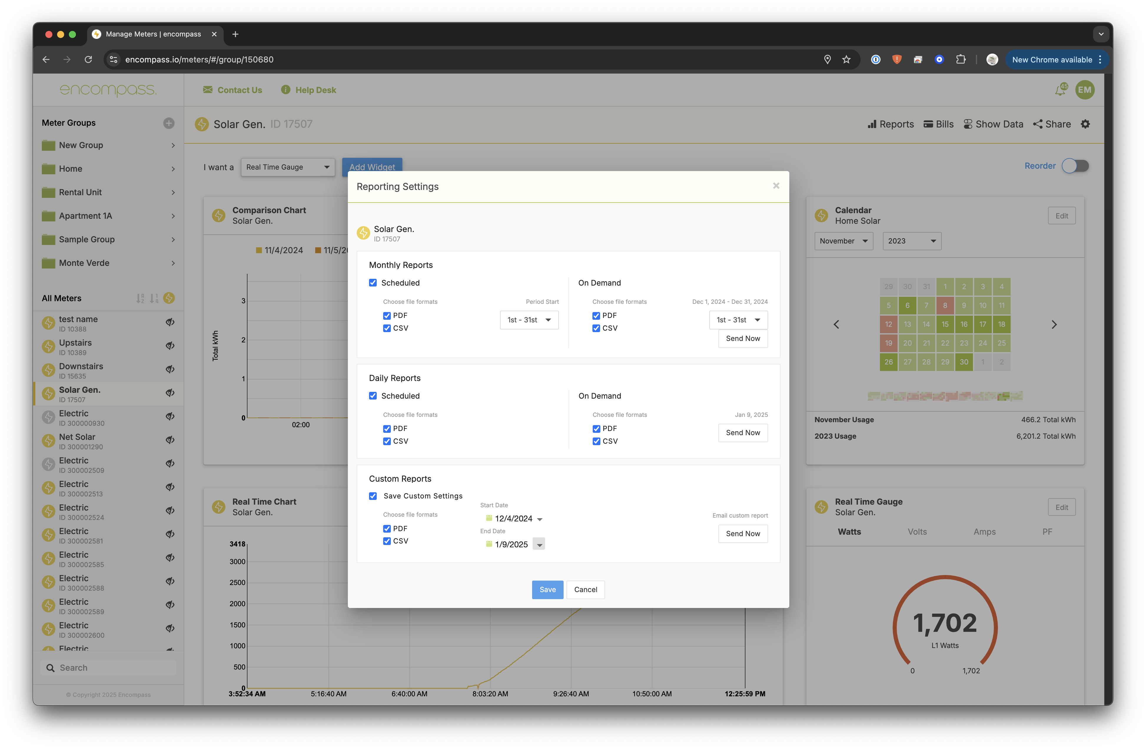

  3. Click on the "Report Settings" option.
  4. If you would like to receive daily or monthly reports automatically check the boxes next to one or both of those options in the report settings modal. By default the reports include a PDF and CSV report but you can choose to uncheck one of those boxes if you wish.
    *Please Note: If you schedule reports you will need to log in to your Encompass account once per year (before 10/16/2023 this was once per 180 days) in order for the scheduled reports to continue. If you do not log in once per year the bills will stop sending automatically. To start them again you would need to log in to your account and check the boxes to schedule them and then click the save button.
  5. Click the Save button when you have your scheduled reports set up how you want.
  6. You can also simply click the "Send Report" button to send a report right away. The report will be emailed to you once it finishes being generated by the reporting system.
  7. The "Custom Reports" option allows you to pick the beginning and end dates for your report. Simply click on the calendar icons to pick these dates and then click the "Send Report" button to generate the custom report.

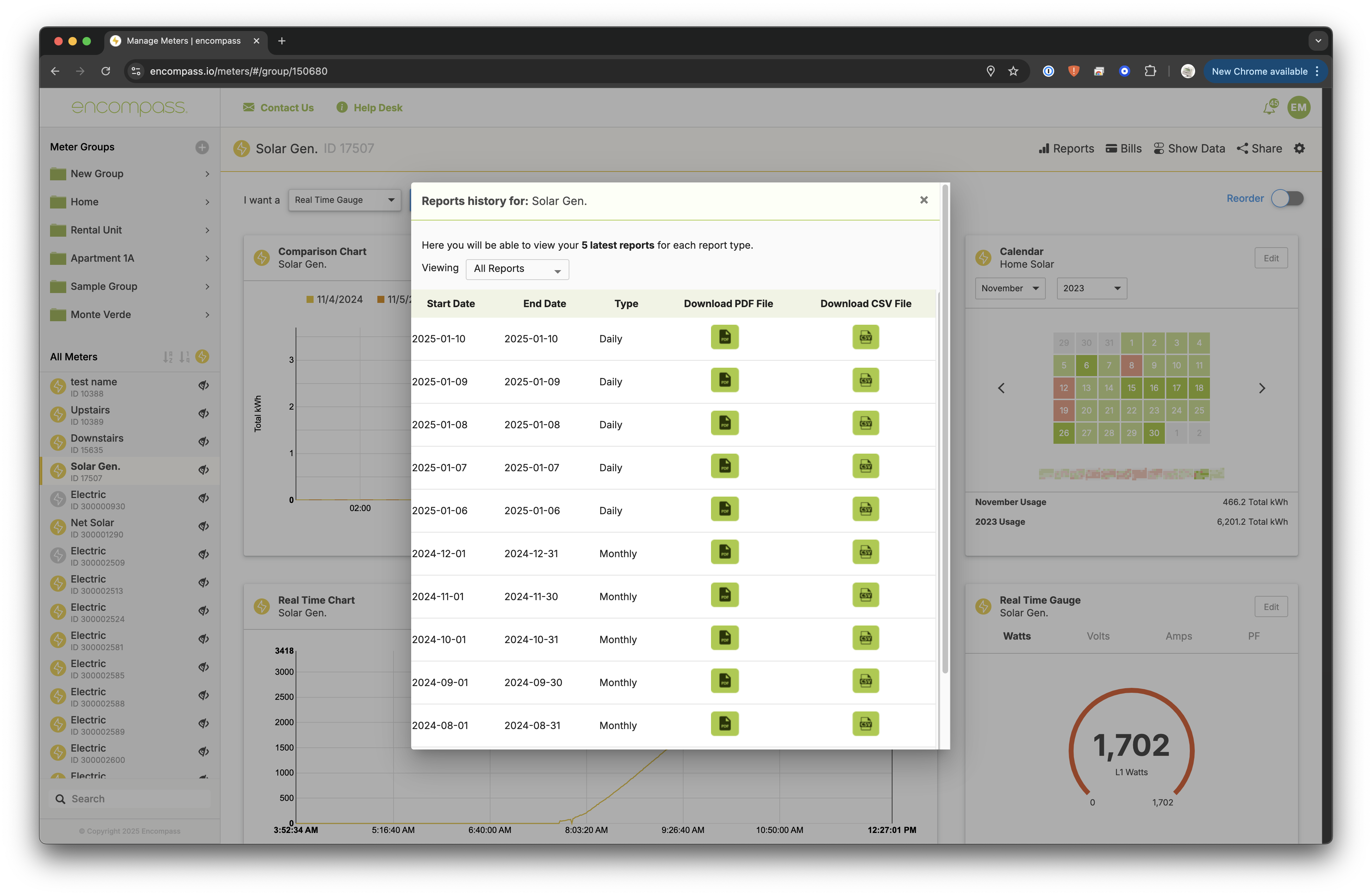

To view all of your scheduled reports, click on you user name in the top right corder of the browser window and choose "Scheduled Reports" from the drop down list. All you reports will then be displayed in a list. You can click on the arrow icon next to a specific report to go to that meter or group.
Modify Billing Settings in your reports.
When reports are generated you will be emailed links to download the report PDF and/or CSV. You can also find the latest links within the app, in Report History. The last 5 reports, of each type (daily, monthly, custom) will be available to download.
