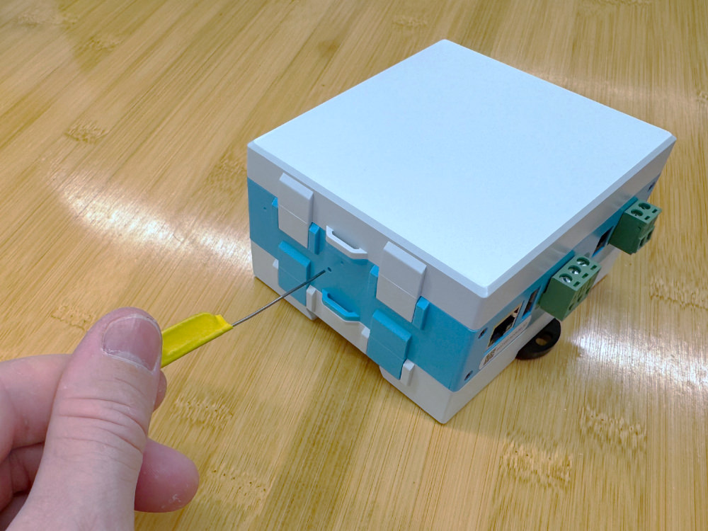

  3. Use your paper clip to press the pin hole button on the side of the Push3 gateway (do not do this before you see the solid green Status LED mentioned above). Press and hold the button then release it immediately when you see the Status LED change color from green. If you continue to hold the button down after the Status LED changes color, the gateway will eventually reset, which you don't want to do accidentally, so only hold it down until the LED changes color. Within about 20 seconds after the first color change, the Status LED will begin cycling through red, green, and orange — confirming that AdHoc mode has been successfully started. The image below shows where on the Push3 the pinhole button is.
